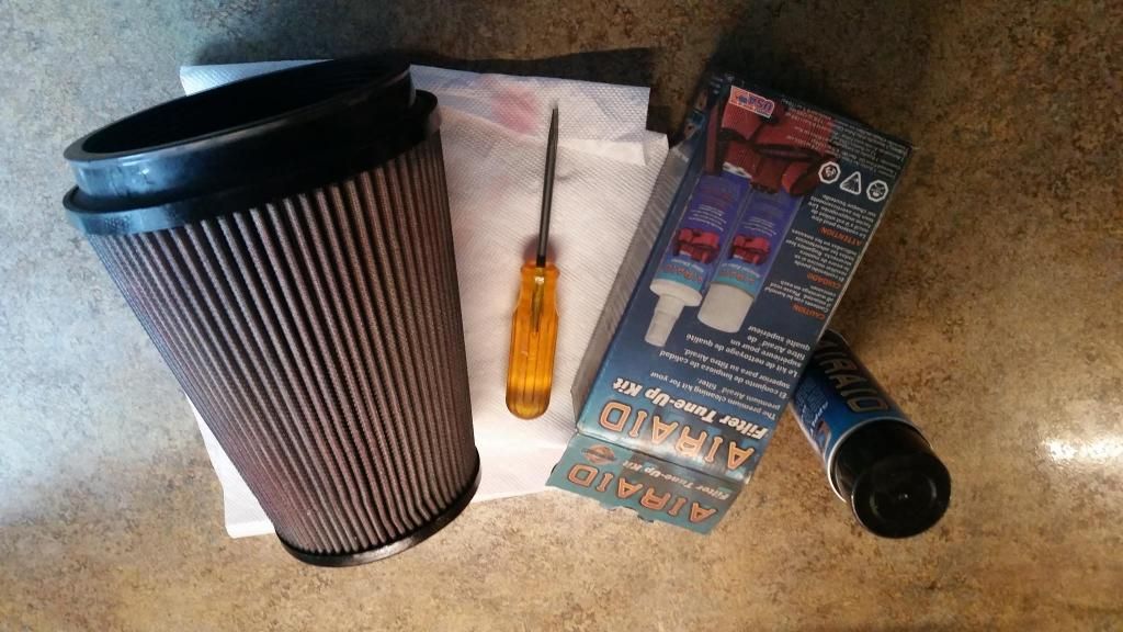

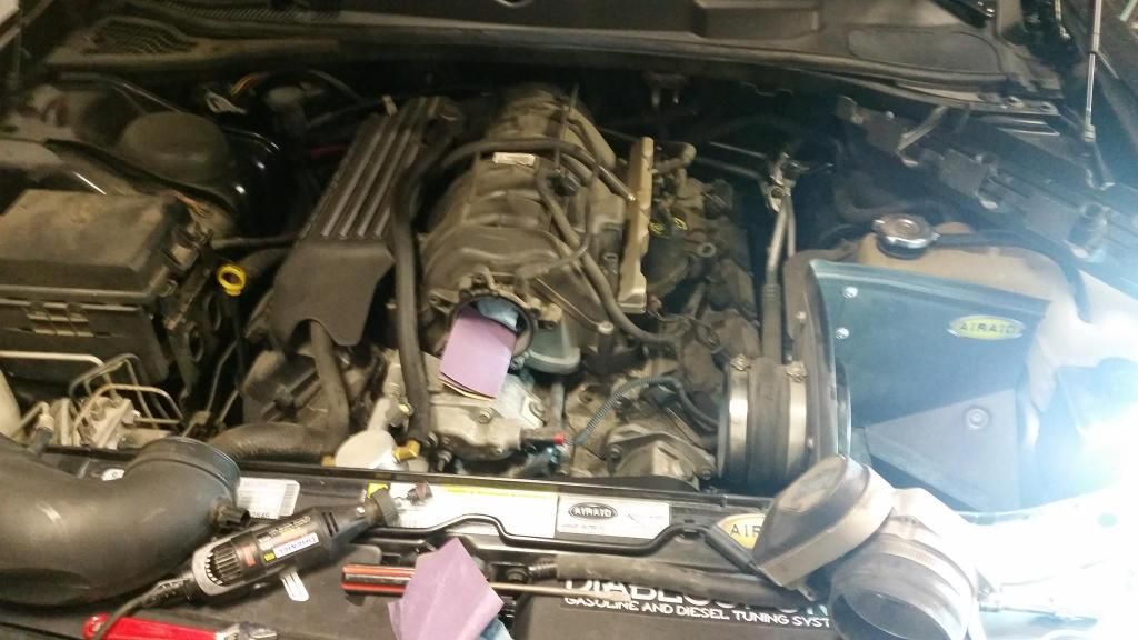

Just a reminder that if anyone is using the 392 chin spoiler to direct fresh air to the CAI, clean the filter element regularly.

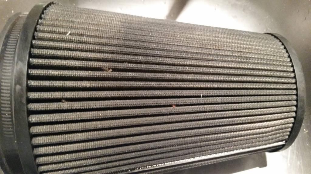

I didn't think mine was dirty until I looked at the side facing the bottom of the CAI (where the air gets blown in from the spoiler).
Critters galore...atleast it's getting fresh air tho.

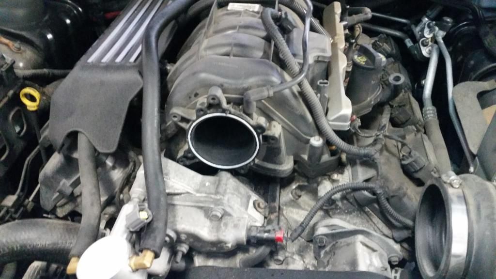

Also spent some time port matching the larger throttle body with the intake. not sure if it helped, but couldn't have hurt as the opening on the intake side was smaller than the throat of the larger BBK throttle body.

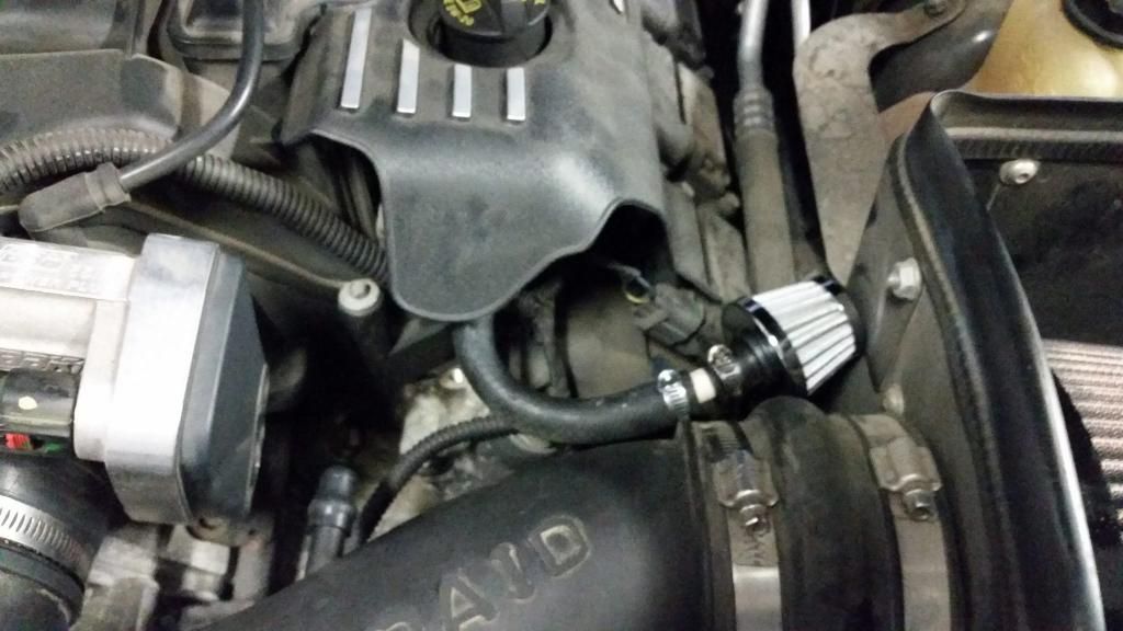

Also attached a filter to the driver side breather, will be routing it into the CAI compartment once I get a step drill bit large enough.
trying to upload the pics...

rest of the pics:
the breather (still need to fab a mount), air filter with the aforementioned critters, throttle body off, light show, my dirty engine bay

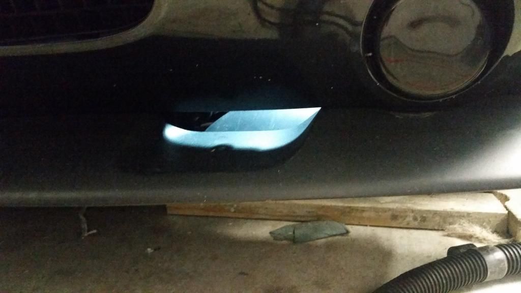

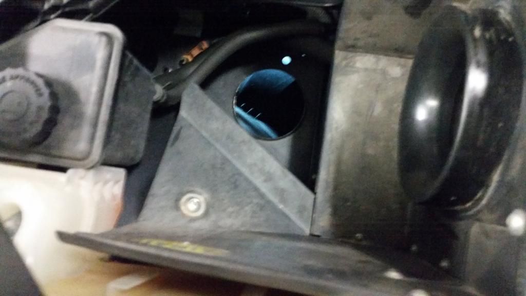

showing direct path from spoiler to air filter using my shop light
I just finished installing the complete 392 spoiler assembly with ducts and belly pan on my 13 RT. I did modify the left duct to supply fresh air for the filter. Hopefully the critters will blow through the duct and not be reflected up into the air filter.
Nice :smileup:
