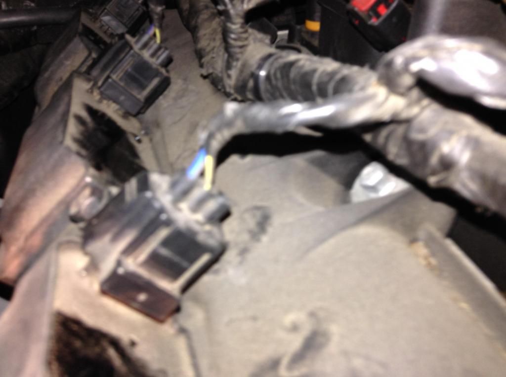

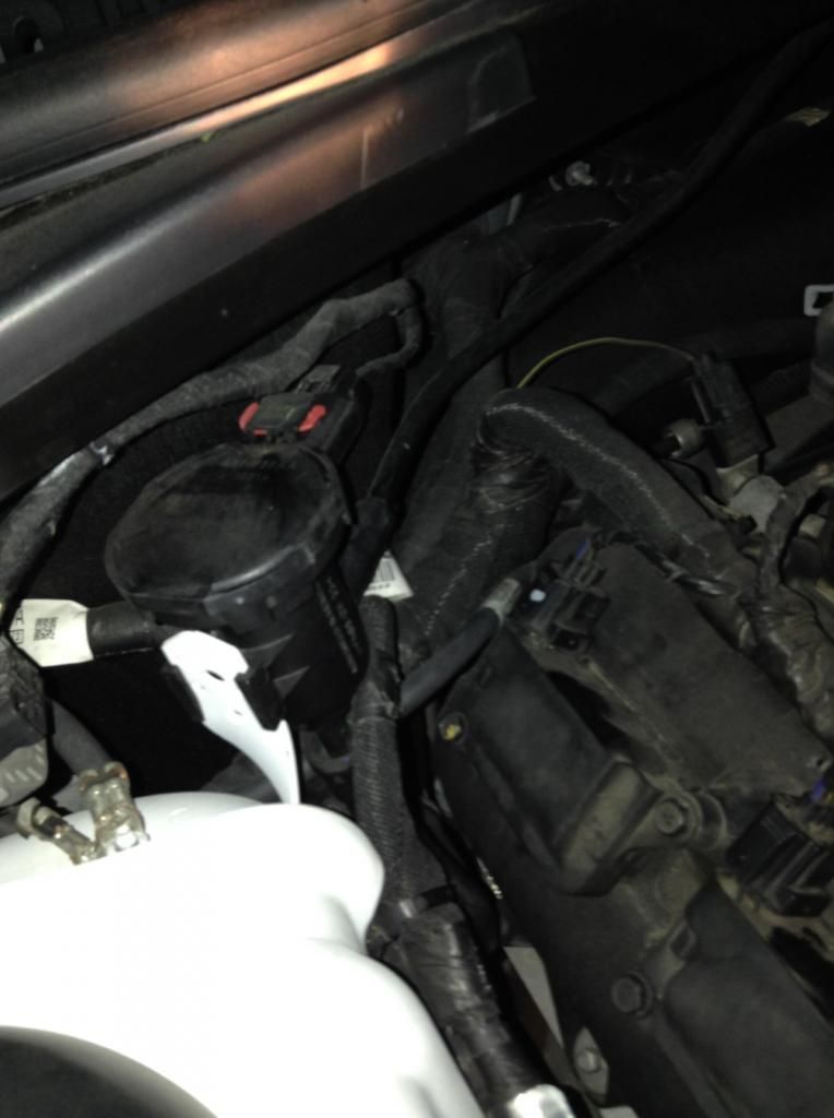

Everybody has made this sound so easy I tried it today. First problem is the rear coil pack on passenger side. The bottom bolt is almost impossible to get to on my 11 R/T due to large coils of wire above it. Finally got that bolt out, and the elctrical connections will not come off the coil packs, I cannOT get it unplugged. Then, that rear cool pack will not clear the wires to come out, I tried for hours and gave up, even watched Speedys garage video. No one mentions this, what am I doing wrong?
Not positive but almost every electrical connector has a locking device that has to be slid back and then a tab that has to be pressed before the connector will come loose. Sometimes when you get to the part of pressing the tab you will need to push the connector on before trying to pull it off to get it to come loose.

I'm assuming the 2011's and 2010's have a similar setup, but it's possible they are slightly different. But assuming it is the same as my 2010, it shouldn't be too hard to remove them.
The coilpacks have wire connectors on them that have two tabs on each side of them. You have to press them in hard enough so they release and then pull up on the connector and it will come out. Some of mine were harder to do than others. It's even harder if it's cold out and your fingers are all frozen haha!
If you have shallow sockets you may need to use those to clear everything with a smaller 1/4" ratchet. I was able to get them all off using that. I only needed the swivel joint to get the spark plugs out when using a 3/8" ratchet.
Can you take some pics of the coilpack you can't get out? I'd like to see what you're talking about because mine were all relatively easy to get out. I think one or two of them were a little harder since there was stuff to clear like you mentioned, but it wasn't too difficult. Post up some pics if you get a chance.
82 Posts
I'll post pix tommorow when I get off work, the connectors don't seem to have 2 tabs, they are all black, I'll take a pic of that too. My car is a 6-speed and has a round item above the rear passenger coil pack and a bundle of wire loomed wires over 1" diameter. If I pull straight out to get the pack off it will hit that large loom.
