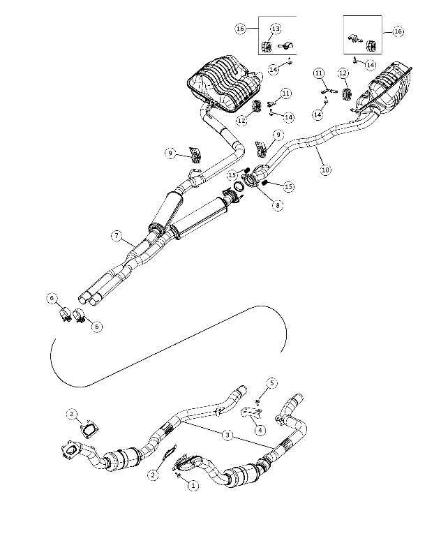

To all who question , Resonators or Mufflers . The way the stock Cat Back Exhaust is installed is in two parts ; part number - 68260150AA - is the Muffler and Resonator Assembly , and part number - 68260151AA - is the Resonator and Pipe Assembly .
Part number - 68260151AA , # 10 in the picture , is described as RESONATOR AND PIPE .
Part number - 68260150AA , # 7 in the picture , is described as MUFFLER AND RESONATOR .
Part number - 68260151AA includes ; 1 resonator with connecting pipe .
Part number - 68260150AA includes ; X-pipe , 2 mufflers , 1 resonator and connecting pipe .
These are the parts as described on the Mopar.com parts website .
68260150AA - Muffler and Resonator Assembly --- # 7
68260151AA- Resonator and Pipe Assembly --- # 10
So with all that said , according to MOPAR , the rearward suitcases are the Resonators and the middle cylinders are the Mufflers .
