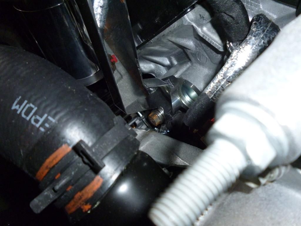

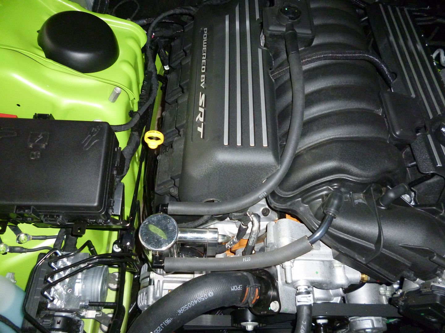

This is where Mickey at Speedlogix really came to my rescue. The directions on this UPR oil catch can said the Z bracket mounted to the timing chain cover but it was clear right away that that couldn't be right. I searched and searched for the right mounting place on the passenger side head but finally gave up and contacted Speedlogix. Mickey knew right away what the deal was. The wiring loom that runs in that area of the head is held in with one of those little push in loom holders connected to the loom and guess what hole it is pushed into....that's right...the one you need to use. It is hidden quite well by the wiring loom and holder and the directions sure don't tell you....heck...they don't even tell you the right part to attach to....THANKS Mickey!!:smileup::smileup:

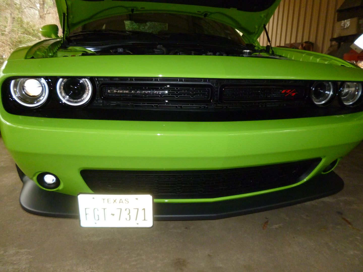

And last but not least....just ask T...LOL:gy:
