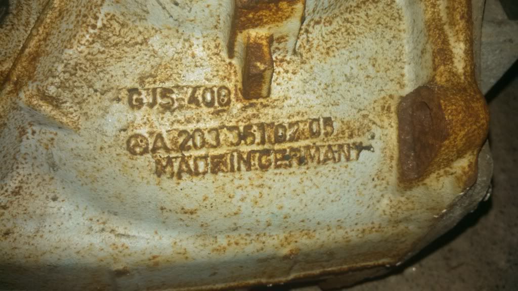

Phil,
Actually the 2013 classics came with POSI rear and both my tires spin same time, that was part of the options i got.
This is the standard open ended 3.06 rear, as you can see it has " Made in Germany" with a Mercedes Benz lo go.
The true Getrag rear has ribs all over it and isnt smooth like the open rear.
