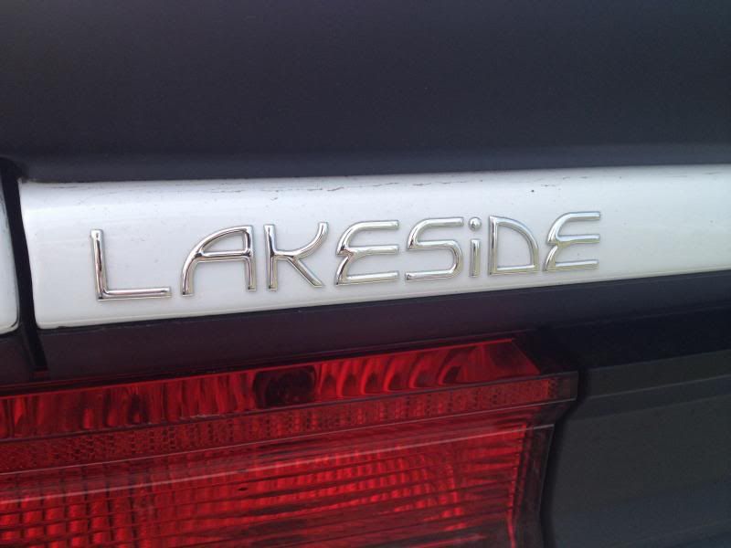

Any body get some advice on how to remove this rascal? I didn't trust them to do it, didn't want to run in to any issues, it's fairly skinny letters... I imagine it won't be too difficult to remove. Any ideas on how to remove it without messing with the paint?

Warm with a letters hair dryer and then use a piece of strong dental floss and work back and forth behind the letter. You may have to use a little goof off or something like that to remove any residual glue. Clean up with soap and water.

It's probably plastic letters and put on with dual sided tape. If so, use 15 lb monofilament fishing line and carefully saw between the letter and the trunk being careful to keep the line pressure off of the trunk and on the letter. Then use Go Gone(not Goof Off, had bad luck with it) to remove the adhesive. Be patient with it.

Like the other guys have said use either dental floss or fishing line.

Thanks guys, that's a good idea. I do believe I'll go with the line idea :smileup:

Most of the dealer badges use a cheap adhesive. Generally you can just heat it a little with a hair dryer and use a plastic squeegee (like the kind you install tint or vinyl with) and just put a little pressure on it and it will come right off. Just go slow and you should have no problems. You can also spray a little WD-40 on the badge and let it soak for a few minutes. This will loosen many adhesives. You can also use WD-40 to clean up any residue left over. WD-40 will not hurt your paint and is great to remove road tar, baked on bugs and lost of other things.
