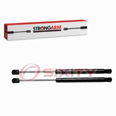

Well I'm not gonna push it It was me the drop that so who's to say. I did call in and they had me email a copy of the receipt so not a big deal is only $35 for the shocks in case anybody is following this thread I got them on Amazon Strong arm 6657. The bottom knuckle rub slightly but I don't think it'll be a problem

#33 ·
It was cold enough yesterday morning and the trunk lid had some snow on it, so with the old struts, I would have to stand there and hold up the lid until the struts "woke up" and held it up, at least 10 seconds. Under 20 degrees, they wouldn't hold it up at all. Now, it's like it should have always been, one finger under the lid and up it goes, and it stays up. Well worth the $40 bucks or so they cost, IMHO.
